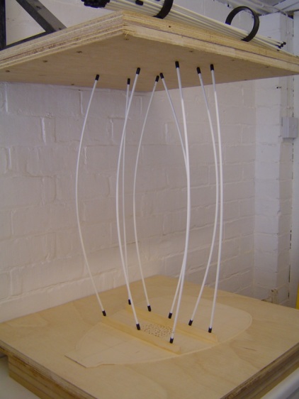

I'm making myself a new go bar deck. I'm thinking of using fiberglass rods from driveway markers (those things with the reflectors on top). Some of you have done that, and that's where I got the idea. So, some questions: once you cut off the reflectors, do you put rubber tips on the rods? If so, where do you get them, or do you make them yourself with that liquid rubber dippy stuff? Any tips on finding and using that stuff if that's how you do it? Is it a piece of cake to cut the fiberglass rods, or are they going to splinter and split on me unless I do it the right way - if so, what's the right way to do it?
The other possibility I'm considering is making rods out of wood. I've only used fiberglass rods. If you've used both fiberglass and wood rods, which would you recommend and why? If you use wood rods and love 'em, what species do you use and how thick do you make them? And finally, I'd be interested to hear how much longer you make the rods than the distance between the decks.

Actually the reflector pulls off with little effort. And yes the ends get rubber caps. That is a must. You can get the caps in the wire closet accessory departments of any big box home improvement store (same one you get your driveway reflectors at) 20 caps for $1.50
My problem with wood is that a given 3/16" dia wood dowel may be stiffer or less stiff than the next 3/16 dia wooden dowel. a 3/16" dia fiberglass rod on the other hand will be the same stiffness as the next 3/16" dia fiberglass rod and they dont fatigue near as fast either. If you do use wood, I would go with hickory for it resilience in flex.
Be aware that if you try to get two rods from one driveway reflector the finished rod length will be 23 5/8". So take this and what you plan on clamping into consideration if you set a fixed height deck
Also I made my deck adjustable using 3/4" all-thread corner post with nuts and washers on both the top and bottom of the upper deck. I can adjust from 2" to 36"
P.S. I guess I should also say I have several sets of rods for several differnt clamping jobs. One set for brace clamping, one set for top and back to rim clamping and another set to misc uses. The top and back to rim set has felt padded chair foot pads on one end to distribute the clamping pressure over a larger surface area at the clamping end. these are a 1" dia. plastic disk with a metal socket on the rod end and 1/8" thick felt pad on the bottom. you can get these in the hardware department at Wal-Mart or any hardware store. The socket is 1/4" inside dia. I epoxy them onto the clamping end of the rod for top and back to rim clamping

I use kite rods, 3/16" thick, from intothewind.com (although there are many others), who also carry the rubber tips. Work just lovely.

As far as costs go, I think I've figured it up before and it's almost the same whether you order from Into the Wind or buy at the local home center. They do sell a nice little Zona hacksaw at Into the Wind which works great for sawing carbon fiber and fiberglass. That may be available at the home center, too, for all I know.

I will warn you that the dense fiberglass rods will dull your bandsaw blade. Yep.

I changed over from Wood to Fiberglass a while back and muck prefer fiberglass, more flex and consistent pressure. I got mine from a Kite supplier Colin told me about in the UK and they offered a cutting service, their rods came in 2.4m lengths so I had them split into 4 even lengths, so maybe into the wind or someone offers the same ?

I haven't tried firberglass, but I have used many different wooden ones, I just rip some on the table saw when I need more or different ones. Ash seems to work really well.

Todd, your hacksaw or a fine bladed bandsaw will work fine on the fibreglass rods, be careful about getting any splinters though, as they are are devil to get out of your finger (don't ask).
I find that 1" is fine for the flex in the rods and I adjust my base to suit the job.
Don't forget the depth of your dish when calculating raising blocks. I keep some extra ply sheet handy for things like lute tops where they don't sit in a dish. Like everything else, just draw a sketch for each situation.

Not me, I have to do everything in grand style...I must have made 60 cuts total to whittle those puppies down to the right size. The dense silica in the fiberglass just wears a blade down quickly! So......figuring in the cost of the bandsaw blade, my total go-bar rod expense using dirt-cheap driveway markers was WAAAAY over the cost of using the kite-store that has the cutting service. Go with the kite store.
Oh, and yes, the little splinters will stay around for a day or two, and the fiberglass dust is aggravating to clean out from around your blade guides, etc.

works great. melts the end fibers so no splintersMichaelP38874.423125

Oh, I don't know; 5 x 10 mm perhaps? Something like that anyway. If you have a table saw, make a few and see how stiff they feel. What I like about ash is it does not break easily, no wonder they used to use it for skis and axe handles! I did make some square ones, but I prefer the rectangular ones so you always know where and how they will bend.
<edit> I went down and measured some, they were more in the 8 x 18 mm range. Arnt38874.6897453704
